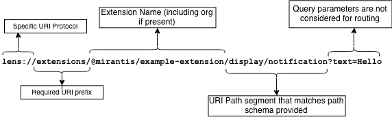

For example consider an extension example-extension which is published by the @mirantis org.
If it were to register a handler with "/display/:type" as its corresponding link then we would match the following URI like this:
Once matched, the handler would be called with the following argument (note both "search" and "pathname" will always be defined):
"search": {
"text": "Hello"
"pathname": {
"type": "notification"
As the diagram above shows, the search (or query) params are not considered as part of the handler resolution.
If the URI had instead been lens://extension/@mirantis/example-extension/display/notification/green then a third (and optional) field will have the rest of the path.
The tail field would be filled with "/green".
