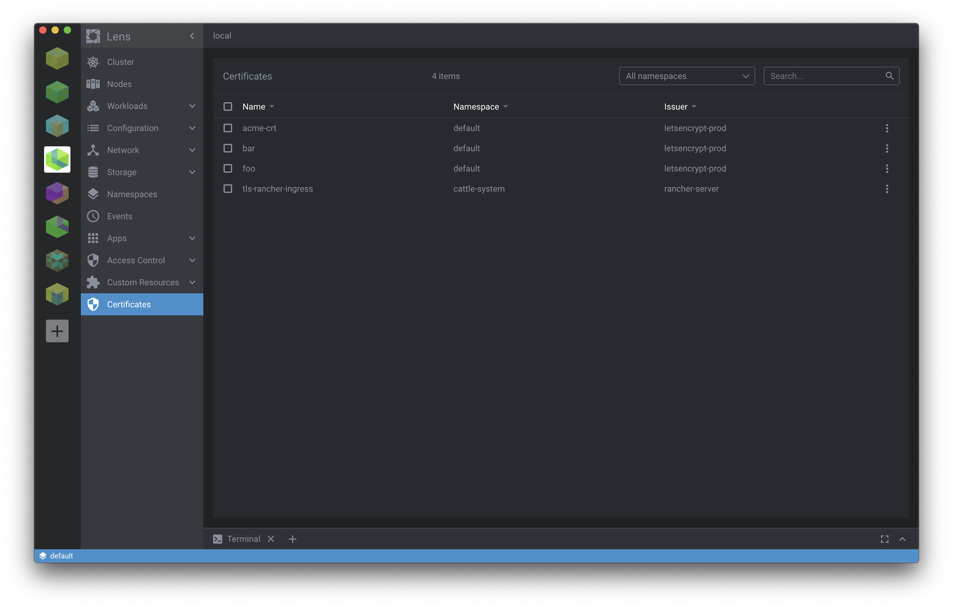

List Certificate Objects on the Cluster Page#
In the previous step we defined CertificatePage component to render certificates. In this step we will actually implement that. CertificatePage is a React component that will render Renderer.Component.KubeObjectListLayout component to list Certificate CRD objects.

Create CertificatePage component#
Now we have created mechanism to manage Certificate objects in Kubernetes API. Then we need to fetch those and render them in the UI.
First we define CertificatePage class that extends React.Component.
import { Renderer } from "@k8slens/extensions";
import { certificatesStore } from "../certificate-store";
import { Certificate } from "../certificate"
export class CertificatePage extends React.Component<{ extension: Renderer.LensExtension }> {
Next we will implement render method that will display certificates in a list. To do that, we just need to add Renderer.Component.KubeObjectListLayout component inside Renderer.Component.TabLayout component in render method. To define which objects the list is showing, we need to pass certificateStore object to Renderer.Component.KubeObjectListLayout in store property. Renderer.Component.KubeObjectListLayout will fetch automatically items from the given store when component is mounted. Also, we can define needed sorting callbacks and search filters for the list:

          searchFilters={[
            (certificate: Certificate) => certificate.getSearchFields()
          renderHeaderTitle="Certificates"
          renderTableHeader={[
            { title: "Name", className: "name", sortBy: sortBy.name },
            { title: "Namespace", className: "namespace", sortBy: sortBy.namespace },
            { title: "Issuer", className: "issuer", sortBy: sortBy.namespace },
          renderTableContents={(certificate: Certificate) => [
            certificate.getName(),
            certificate.metadata.namespace,
            certificate.spec.issuerRef.name
      </TabLayout>
