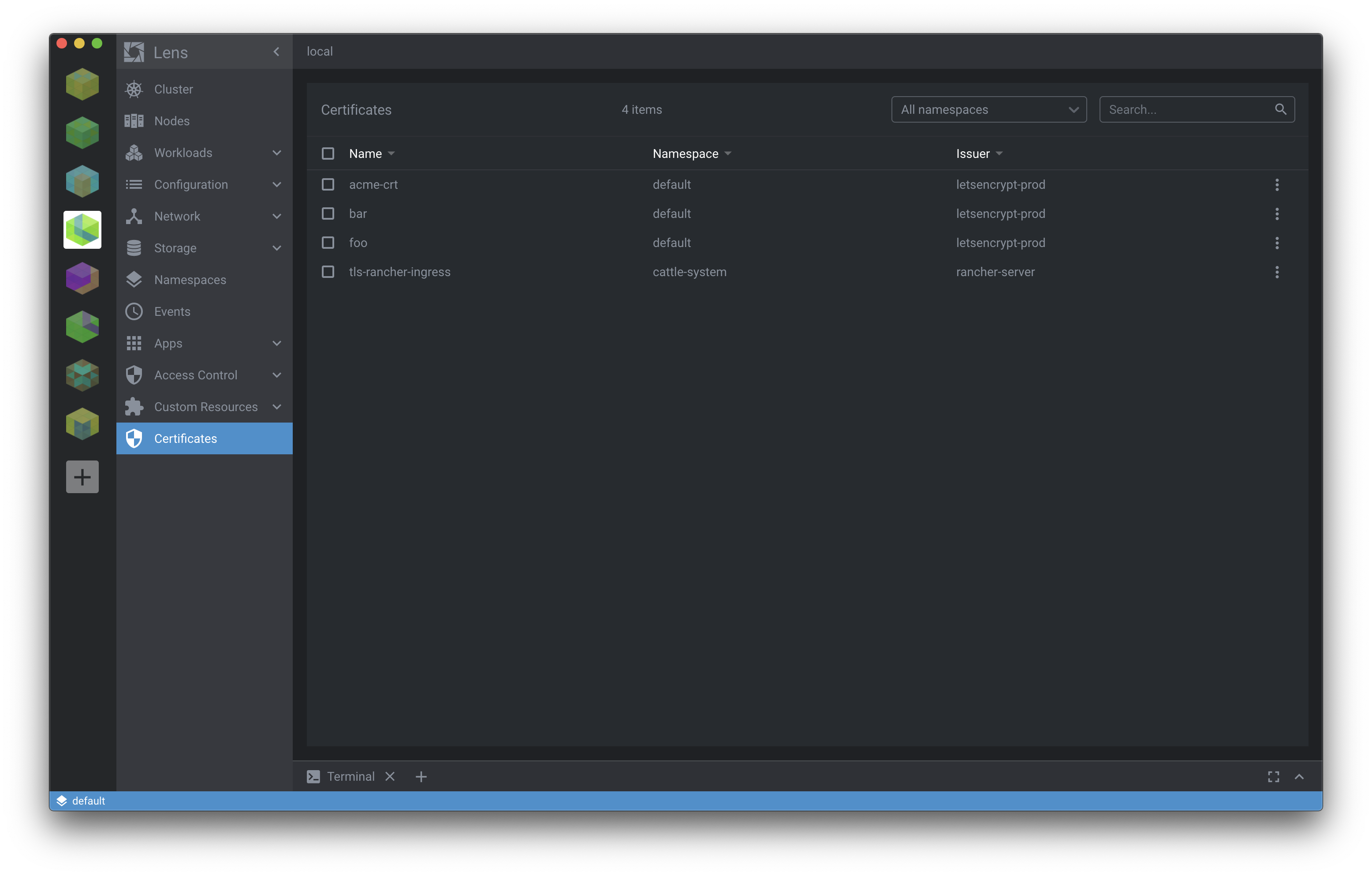

List Certificate Objects on the Cluster Page#
In the previous step we defined CertificatePage component to render certificates. In this step we will actually implement that. CertificatePage is a React component that will render Component.KubeObjectListLayout component to list Certificate CRD objects.

Next we will implement render method that will display certificates in a list. To do that, we just need to add Component.KubeObjectListLayout component inside Component.TabLayout component in render method. To define which objects the list is showing, we need to pass certificateStore object to Component.KubeObjectListLayout in store property. Component.KubeObjectListLayout will fetch automacially items from the given store when component is mounted. Also, we can define needed sorting callbacks and search filters for the list:
enum sortBy {
  name = "name",
  namespace = "namespace",
  issuer = "issuer"
export class CertificatePage extends React.Component<{ extension: LensRendererExtension }> {
      <Component.TabLayout>
        <Component.KubeObjectListLayout
          className="Certicates" store={certificatesStore}
          sortingCallbacks={{
            [sortBy.name]: (certificate: Certificate) => certificate.getName(),
            [sortBy.namespace]: (certificate: Certificate) => certificate.metadata.namespace,
            [sortBy.issuer]: (certificate: Certificate) => certificate.spec.issuerRef.name
          searchFilters={[
            (certificate: Certificate) => certificate.getSearchFields()
          renderHeaderTitle="Certificates"
          renderTableHeader={[
            { title: "Name", className: "name", sortBy: sortBy.name },
            { title: "Namespace", className: "namespace", sortBy: sortBy.namespace },
            { title: "Issuer", className: "issuer", sortBy: sortBy.namespace },
          renderTableContents={(certificate: Certificate) => [
      </Component.TabLayout>
