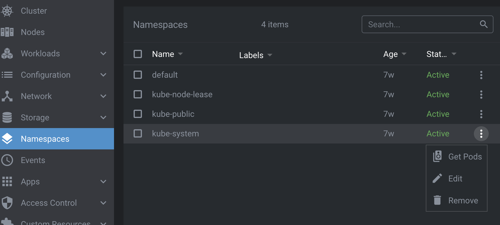

kubeObjectMenuItems
An extension can add custom menu items (including actions) for specific Kubernetes resource kinds/apiVersions.
These menu items appear under the ...
for each listed resource in the cluster dashboard, and on the title bar of the details page for a specific resource:
The following example shows how to add a menu for Namespace resources, and associate an action with it:
import { LensRendererExtension } from "@k8slens/extensions";
import { NamespaceMenuItem } from "./src/namespace-menu-item"
export default class ExampleExtension extends LensRendererExtension {
kubeObjectMenuItems = [
kind: "Namespace",
apiVersions: ["v1"],
MenuItem: (props: Component.KubeObjectMenuProps<K8sApi.Namespace>) => <NamespaceMenuItem {...props} />
Kube object menu items are objects matching the KubeObjectMenuRegistration
interface.
The kind
field specifies the kubernetes resource type to apply this menu item to, and the apiVersion
field specifies the kubernetes api to use in relation to this resource type.
This example adds a menu item for namespaces in the cluster dashboard.
The components
field defines the menu item's appearance and behaviour.
The MenuItem
field provides a function that returns a React.Component
given a set of menu item properties.
In this example a NamespaceMenuItem
object is returned.
NamespaceMenuItem
is defined in ./src/namespace-menu-item.tsx
import { Component, K8sApi, Navigation} from "@k8slens/extensions";
export function NamespaceMenuItem(props: Component.KubeObjectMenuProps<K8sApi.Namespace>) {
const { object: namespace, toolbar } = props;
if (!namespace) return null;
const namespaceName = namespace.getName();
const sendToTerminal = (command: string) => {
Component.terminalStore.sendCommand(command, {
enter: true,
newTab: true,
Navigation.hideDetails();
const getPods = () => {
sendToTerminal(`kubectl get pods -n ${namespaceName}`);
<Component.MenuItem onClick={getPods}>
<Component.Icon material="speaker_group" interactive={toolbar} title="Get pods in terminal"/>
<span className="title">Get Pods</span>
</Component.MenuItem>
NamespaceMenuItem
returns a Component.MenuItem
defining the menu item's appearance (icon and text) and behaviour when activated via the onClick
property.
getPods()
shows how to open a terminal tab and run a command, specifically it runs kubectl
to get a list of pods running in the current namespace.
See Component.terminalStore.sendCommand
for more details on running terminal commands.
The name of the namespace is retrieved from props
passed into NamespaceMenuItem()
namespace
is the props.object
, which is of type K8sApi.Namespace
This is the api for accessing namespaces, and the current namespace in this example is simply given by namespace.getName()
Thus kube object menu items are afforded convenient access to the specific resource selected by the user.

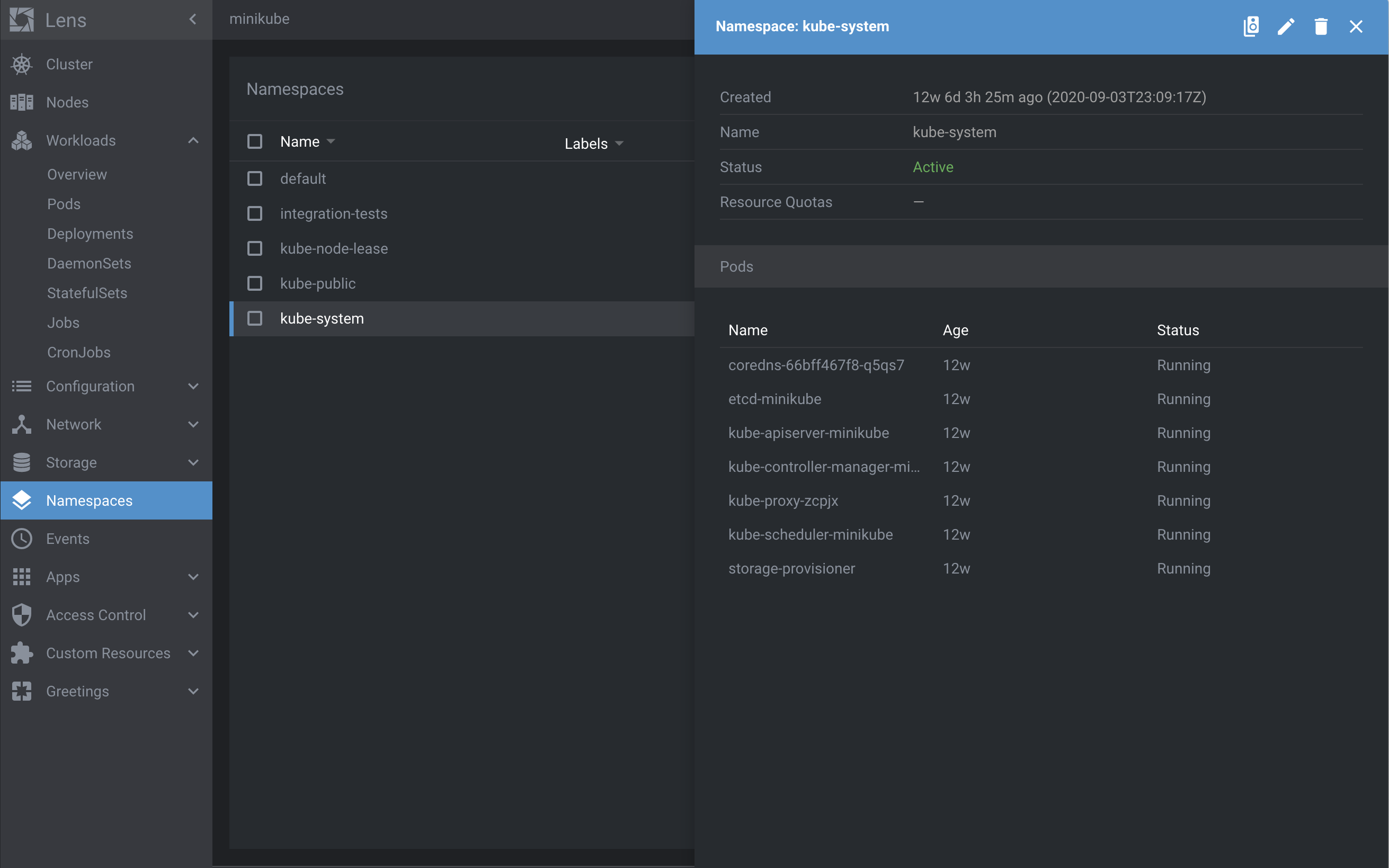

kubeObjectDetailItems
An extension can add custom details (content) for specified Kubernetes resource kinds/apiVersions. These custom details appear on the details page for a specific resource, such as a Namespace:
The following example shows how to add a tabulated list of pods to the Namespace resource details page:
import { NamespaceDetailsItem } from "./src/namespace-details-item"
kubeObjectDetailItems = [
kind: "Namespace",
priority: 10,
Details: (props: Component.KubeObjectDetailsProps<K8sApi.Namespace>) => <NamespaceDetailsItem {...props} />
Kube object detail items are objects matching the KubeObjectDetailRegistration
interface.
The kind
field specifies the kubernetes resource type to apply this detail item to, and the apiVersion
This example adds a detail item for namespaces in the cluster dashboard.
The components
field defines the detail item's appearance and behaviour.

PodsDetailsList
produces a simple table showing a list of the pods found in this namespace:
For each pod the name, age, and status are obtained using the K8sApi.Pod
methods.
